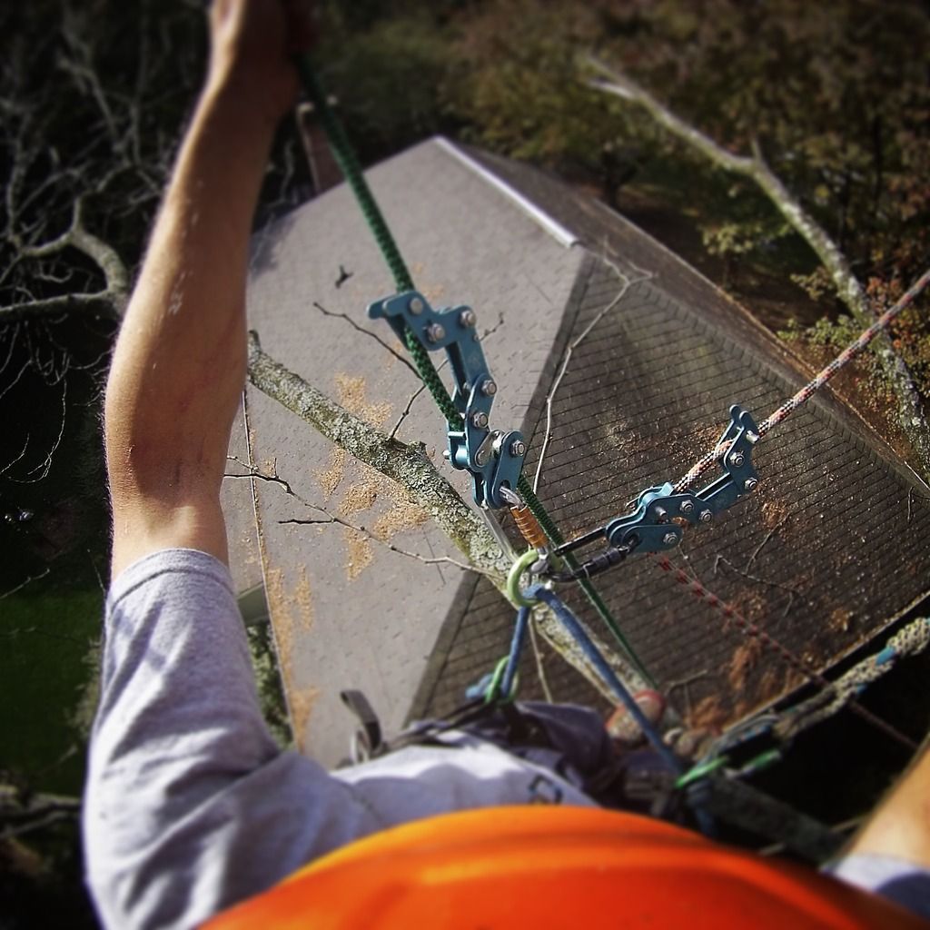

So I have been tending by the first picture. It works pretty well. But occasionally I get some decent drag from this position. I really started to take a look at my bridge and see if it was causing the pulley to bite on the rope, but found this wasn't the case with me.
A week ago I tried a new tending spot. I am confident enough to call this the "money spot" (pic 2 and 3). I drilled a hole straight through the body with a number 40 bit and weaved some arbpro stiff throwline through there. I cannot believe how amazing this thing tends from this position. I have not had one instance and any unwanted friction at all.
Drilling here does not compromise the structural integrity of the runner at all.
Very happy with this.

Mike do you think there is a chance of the throwline getting jammed in the upper part of the RR to not allow the spring to push up causing a malfunction?
It is a possibility. That had the potential to happen with the tether in the first pic I posted as well. That is one of the reasons I put some shrink wrap in the middle, tightening things up a bit. Generally my thumb blocks the bird and the tether always flops down and stays out of the way. Soo smooth I'm tellin ya.
I agree mike that it tends amazing from that spot. The reason I did not make that the official tending spot is that I found that if you lean back, it will cause the runner to pull away from the lower friction point causing unwanted descent. So if you were to say, get knocked out while ascending and you fell back against your tending harness, you would slide down the rope.
I am gonna play around with those scenarios. Thank you for bringing that up Kevin. I think I'll be taking my chances for a minute. Incredibly smooth
Today I re-enacted the scenarios Kevin was talking about. With all my weight in my chest harness laying back, the runner didn't budge. When I forcefully leaned back and pulled my hardest it creeped oh so slightly. So I think I am comfortable tending from this position thus far.
