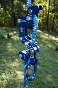

First day on the rope runner

Tried the 1/2 km3 today, it's like the heavy duty version of rope. The diameter isn't much different than Tachyon which was a surprise, but so far I like it.
Blue sexy.
That photo should be used as an ad shot for the Rope Runner. It makes it look just gorgeous.
Maybe I missed it, fitz, but you purchased your Rope Runner fairly recently, correct? I'd love to read about how well you get on with it. Specifically, I'd like to know about how it feels with regard to the spring tension on the bird.
I think Stihlmadd posted some pics of his Rope Runner in which he'd added some Sugru to the beak of the bird, as a cushion.
I also think the combination of colors looks great. What biner is that, if you don't mind my asking?
Congrats, and I hope you have a blast on it!
Tim
Very nice, way to coordinate color. Highly fashionable.
Yeah, it matches my underwear.

Me and the RR have been through a lot, a bit of a story, I've owned the gold, black, and of course blue. If you are coming to the Expo maybe we can meet up and I can tell it to ya.
Sugru might be needed more for certain kinds of rope, the Tachyon for instance I've found easy to push down on the bird, my new km3 I've found to be a lot harder but maybe with time it will become easier.
That's the DMM biner, I think it works better than the RockO in a few ways. It's a little more compact, if you are pushing up the RR with the biner you won't keep pushing on the spring lock. Since the DMM is more consistently round it wears on the body of the RR more evenly, the RockO would just rub on one side.
https://www.treestuff.com/store/catalog.asp?category_id=130&item=2026
