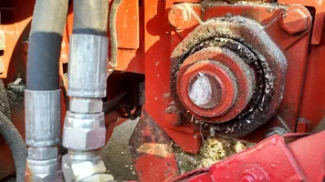

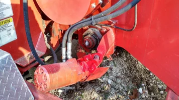

So..it happened to me today too. I purchased this 2010 morbark m15r with about 1000 hours on it a few weeks ago, Hardly used at all. Today I was feeding it with brush and it worked fine. Then I noticed the bottom feed roller stopped moving. This is what I found.
Now, I purchased this as a private sale However this is clearly a bad design on Morbarks part. What is my course of action? Being that I have not purchased this from a dealer?

It looks like a corrosion problem, at least from your pictures. I truly don't believe morbark will help. This is not to say that you shouldn't contact them, maybe you'll be surprised. Do sticks, chips, dust collector around this area? This might accelerate the corrosion. That 1390 is lookin pretty good huh? :)
Nothing collect there. No, I am very happy with this machine. Also I got it for a good price and figured there would be some things that needs fixing. Just wasn't really thinking it would be this. I was imagining small things. Does this have to be fixed by morbark? I might attempt it. Does the whole bottom feed wheel need to be replaced?
Company I work for had a feed wheel shaft break, they were able to have a new shaft welded onto the feed wheel. Might save some cash. Do you have another chipper? If so I say go to work and let someone to fix it.
Yeah, I have another chipper. I just got the morbark. I need it for a large job in two weeks. I am dropping it off to Morbark on Monday to get fixed. I want it down right so I don't have to worry about it again. Plus, then it's on them if it breaks again in a short time.
