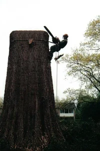

Re: \"Extreme Rigging\"
This is the only photo I could find. Its the right tree in question but you'll just have to imagine me standind proud with my chopper in hand!

Laz , I wouldn't do it , it be done. Of course the lags would hold , but it is work. What do you do with all the pieces of wood with steel in them ? more work . I would buy a cheap short axe from a local hardware store, and chop the Ivy off the trunk before I got involved in drilling holes and installing hardware. A lag is for anchoring , not lowering . I've seen people back in the seventy's lower half inch line off of lags , only because they cut the cables and thought they be a good fixed lowering option. it worked , but the work of installing the lags was allready done. I can't see me tying a sling and block being less productive or safe than that method. Extreme rigging isn't this , don't make me go there.
