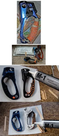

Re: Petzl Dual Ascender Build
As you can see, I chose to whip the handle tighty, letting the excess ethicone schmeear up into and around the windings to hold the line in place.

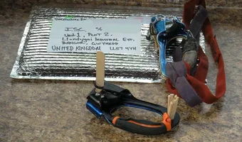

That was version 1,
I beat the snot out of those for well over a year, they were awesome.
I ended up sending them to ISC in Wales, who then sent them on to Gary Storrick for inclusion into his permanent collection, a new subsection of his expansive collection, headed under "Single Handled Dual Ascenders."
Sending this version off gave me the incentive to make the next version, which were to include a couple of new updates.
Stay tuned:

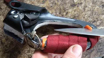

On this one, chop sticks and a tongue depressor worked excellently in aligning the sides perfectly while the M1 sealant-adhesive set up, about 6 hours.
I chose to whip the handle in 1/2" tube webbing. I guess this handle treatment is optional. I thought the Zing-It line, whipping would add strength and integrity, and I'm sure it does, but it becomes so strong over-the-top, I would only use it again from purely a comfort standpoint.

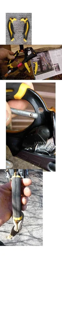

That's what defines VERSION 3,
it uses the new black and yellow Ascensions, and no whipping on the handle.
Here's a number of images, and final editions of improvements to the redundant safety features.

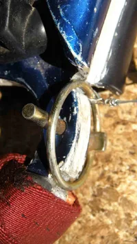

Notice how in this first image, I eye-spliced a short piece of 3 mm dyneema and sunk it in between the ascenders, held firm between them and by the bonding power of the ethicone. It gives a mini attachment point, more detail on that in a minute.
Note in the bottom image, I have left an opening between the two top-holes,
a loop of 3 mm dyneema could be captured by the pin if one were to use that as a backup prussik.

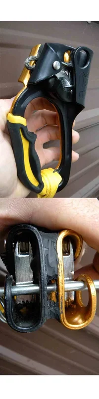

But here is the true essence of this ascender.
The magic lies within the DUALLY-REDUNDANT backup safety features.
This negates the need for a secondary prussik.
(Earth shakes....)
The entire Story revolves around this one, key point in the November '09 TCIA article, The Single Handled Dual Ascender: a concept device. It was basically all about this central safety feature that is new. The dual ascender is nothing new at all. And the problem of backing the dual ascender up has always been a problem until I figured it out as shown in these next 6 photos:
This piece prevents the cams from EVER being able to fully open. Thereby blockin the ability of the cam to allow a rope to pass. Period. That is one redundancy.
The second redundancy is the PTO Hitch pin through the top holes. This prevents the rope from EVER being able to escape the ascender shell, even if one or both of the ascender cams is released, either intentionally or not.
At the same time the dual ascender now has adjustability, up and down, instantly and without ANY appreciable resistance (friction).
The left and right cams can be operated ONE-HANDED, both together, or individually of one another. I will end on that most important point; ease of use and response and safety and versatility and swiftness and ease and confidence.
For me, I make money climbing trees so the more efficient, the more money,
ya know?
This PIN, that blocks the cams from opening beyons a certain point allows the climber to instantly adjust-down, but on the up-ascent, of course, is where the paired ascenders really kick .
You are 1:1, huge advantage, and an ascent device that will self-tends if you want it to. You heard me. No slack tending.
