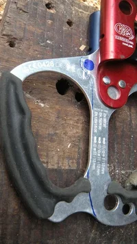

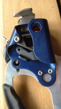

Re: Dual Petzl Ascensions
Closed.......
...... and open.

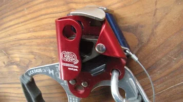

See that little protruding tab in the mini-biner hole? I have to remark on their design, one can not use the ascender with the captive plate held 'open' by the mini biner by someone so inclined to do that. The system almost requires that you employ the dual redundancy features, just to be able to climb on them, and the features themselves don't get in the way of the performance of the ascender(s), making compliance in using the onboard safety features more assured. The captive plate engages automatically after the rope is installed. All you do is positively secure it by inserting a mini biner in a hole. Nice. More dummy-proof, some might say.
In the ones we'll be making, coming up, the dual redundancy in not internal as here with the Kongs, but attached where one, or the other can be used independent of the another, so you have to tell the ascender what you want, rather than the ascender telling you what it requires.
The tradeoff of one additional motion (~2 seconds) is having the nice, meaty single handle, and the performance that is uniquely awesome to the Dual Petzl Ascensions, two motions to employ dual redundant safeties backing one another up, rather than just clipping in a mini biner on the Kong to employ the integrated safety features. Kong has it really boiled down. However, as I'll share upcoming, the Petzl matches or exceeds performance in all other respects, except for fine, polished appearance.
Performance over looks any day, thank you very much.

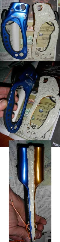

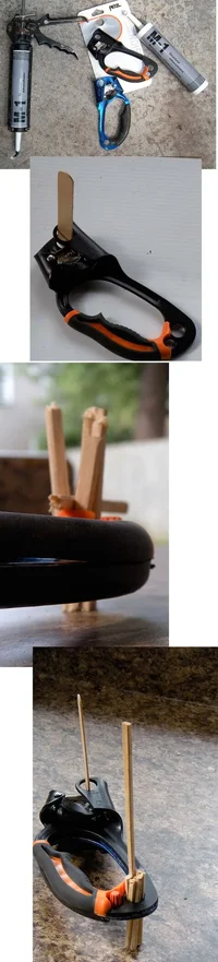

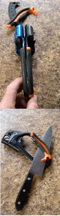

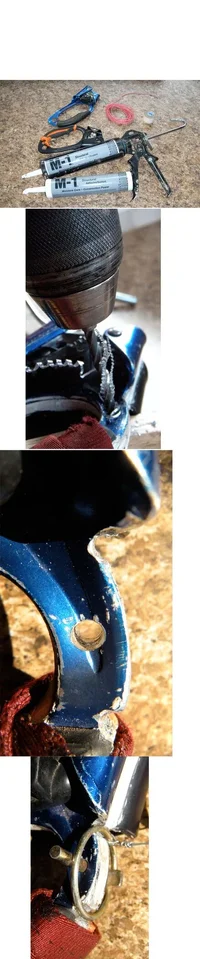

I'd like to post 4 pictures per post, otherwise this could take a long time.
Getting ready, getting your stuff in order, bonding sealant-adhesive (Ethicone)
and clamping devices, chopsticks and tongue depressors.
Really high tech. The Ethicone is the bomb, at three hundred pounds per square inch bonding power, I calculated ~9-1/2 square inches, that's over a <u>ton</u> of bonding force.
