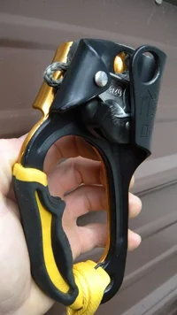

The below ascender was 'donated' to Petzl USA at TCIA, so if any of you think I should be talking to manufacturers, they're quite aware.
Here is what Petzl 'donated' back. This is where our thread begins, Version 3

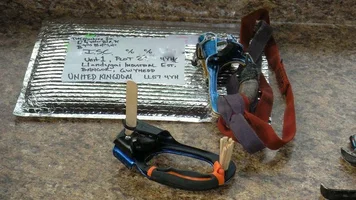

Just as a formal signoff to the past versions, here is version 1, well- beaten and on it's way to the UK. They had their look, and then sent it on as a new classification of ascender in the Storrick Collection .
Gold and blue were two older version Ascensions. AMazing, look at the picture of it new and freshly built up above a few images, and then its condition at send-off. That was 9 months of climbing in even the crappiest weather. Version 1 rocked. How to make version 2 any better was going to be a stretch.
The next model, the black and blue was an old version/ new version hybrid and was further refined in it's safety features. not much but tried some new things and learned. I only climbed on version two for 4 months
The ones we'll be building and rigging from here on out are the full-new version 3, Spring, 2010 Single Handled Dual Ascender. In version 3 we upgraded our technology beyond tongue depressors and chopsticks and went with mini clamps from the dollar store. A couple new tweaks to keep this ascender easy, user-friendly and super safe.

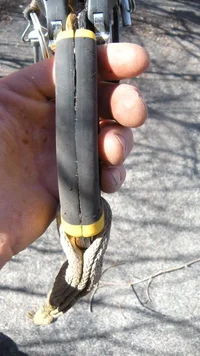

Just a comment about mating the frames. I pretty sure I don't want to shave the inner plastic on mine because I like the fat grip. Just sayin'.
Re: Dual Petzl Ascensions
Well, Sir, that was why the Zing-It whipping on version 1, to make the handle firm and fat.
On version 2, the winding and adherence of the 1/2" tube webbing made an even fatter handle. See the image two posts ago? the one going up the dual black rope. THAT was a fat handle.
One of the major advantages of this particular ascender, like the Blinkster is just sayin.... is a comfy, sturdy handle so you can do that much less two-hands-on-rope and you exploit the advantages of that.
Tree climbing is hard work. Any way you can make it easier, y'know?
So, on VERSION3, and as of this writing I have only been climbing on this set about 5 months. Below is what Version 3 looks like, currently no whipping on the handle.
Good note about the handle, Blinky. That's a critical element.
