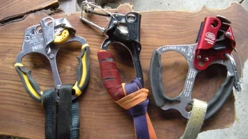

Re: dual Petzl Ascensions
I use tape and a bow shackle...
I like to take the inside handles off so the contact is frame-to-frame.
The shell and handle of the Ascensions have remarkably flat surfaces once the handled are trimmed.

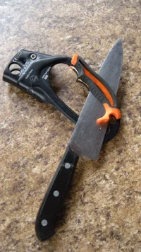

Here's two single Ascensions.
and here's about two minutes later. The old ascensions as shown here were 100% rubber handled and were easy to cut off with a chef's knife. The new version are a combination rubber/plastic.
I'm really <u>not</u> encouraging anyone to do this, but if you do, please be very careful.
