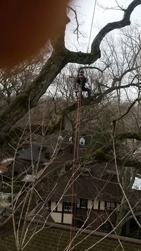

How did you do that Kevin? Did you ascend the central line with the two outliers in tow, and then pull yourself into position as if you had grappled the outliers?

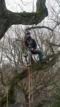

Kevin, now I want to see you flip with a chainsaw! I see you had a handsaw... You are a superstar. I like that red and black Rope Runner too.
I can't say I DRT every day, but I am going to two lines far more often. I really do love the way you can almost float through the canopy. I was one of them that was skeptical at first, but now find that two lines is not that hard to manage and does so much to aid you while working a tree. So Kevin - Thanks for leading with style.
I ascended my normal doubled rope ascent which is my favorite method. I swung over to the second tree and redirected one of my lines. I tried the tree drt but it was swaying to crazy and sketchi ng me out.
Johnny pro was in third tree and he sent me over his bone and I was able to float up the tree. Pantin ing up each line individually until I couldn't go any higher. I went up maybe four or five more feet from where I was in the video. And I was able to snap cut the top out. I snap cut the whole spar down to about 15 feet. Floating above the spar on the way down was a trip.
