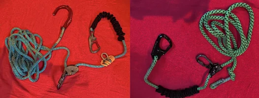

Call it what you want. The Grigri needs to be properly oriented, depending on which side is in use, but this is the general idea for my lanyards. The 2in1 is for an SRT single connection point on the rope bridge and the lanyard on the right is for the hip rings.
I saw it somewhere, but can't find it at the moment. What width is your chafe sleeve? Mine is a tighter fit, which I thought would be better. It isn't because it won't pile up enough to get out of the way when I need a short adjustment.
Any suggestions or tips to avoid a hardware cluster mess would be welcome.
