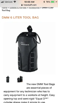

So what bag is everyone using?
Right now my hook is on the back end of my 25' lanyard and the rope is loose coiled on a 4 point scuba clip. This works but gets messy when I am feeding rope at both ends.
I am eyeballing the magnetic lanyard bag from sherrilstuff, but I am really finding that I want a 25' lanyard, AND I want more rope on the hook to throw with.
So I guess I need a smallish lanyard bag, and a hook bag that will hold 50 feet or so. Recommendations?

For what it's worth the small dmm gear bad that comes with the kit is imho too small to be used effectively
If I remember, some people got theirs with the 4 litre DMM bag, but most got the 6 litre bag. I tried the 4L bag for awhile but it was too tight for 50' of cord. The 6L seems just right.

. . . I'm currently coiling my set-up but a bag might save some time. Could the New Tribe Open Climbing Bucket be an option? If you are leaving a portion of the line out as a quick access lanyard, a smaller bag may work.
I have only gotten to use my hook a couple times so far, with this constant rain we are having up here this Fall/Winter, and I only have the 30 feet or so of line on it that comes on the longer CE lanyard, but I am using the neat bag that comes with the NT Yellow Jacket saddle. I was leaving out maybe four feet or so of the lanyard end, with the rest of the line in the bag and the hook hanging just outside the bag. I think the bag would hold somewhat more line too.
Is the Yellow Jacket bag a ditty sack with a draw cord top? I've seen the saddle but not the bag.
Yes, it does have a drawstring top. It is not as deep as the bucket, but it is wider and probably has slightly more volume because it has a circular profile with a flat bottom, whereas the climbing bucket has an oval cross section and a rounded bottom. I don't think the climbing bucket is large enough. The Yellow Jacket bag has a loop in the bottom that you could tie the end of your line to, but it doesn't have a belt attachment like the bucket: The bucket doesn't have the loop in the bottom. The NT Easy Rigger Saddle Bag looks like the climbing bucket with the addition of the drawstring top. Might be your best bet. New Tribe also sells the camo version of the Yellow Jacket bag for their Aero Hunter saddle.

Easy rigger bag is perfect. It fits 40 feet of pink husky, a cinch, micro pulley, and the hook with spare room. I was using a little line mug, too small. Plus my favorite part is the webbing handle is detachable on the side with Velcro and a snap so it can be strapped to my leg loop or belt without flopping.
