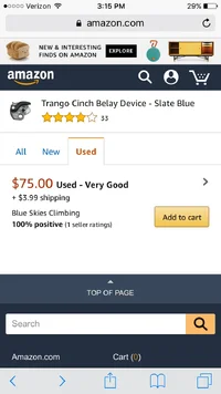

Trango Vergo is available from REI, direct from Trango and probably other gear retailers. There was a limited batch recall in 2017, that's been resolved. Handle problem, reminiscent of the Petzl Grigri II which also had a handle recall in the first release. I'd be interested in the Vergo except I already have a Cinch. Vergo looks better than the Cinch as far as having a more robust handle. Vergo still looks a good match for a Hook line progress capture.
-AJ
My line is 11mm and the specs are up to 10.7 mm. Wish I got the cinch when still available. Oh well. Going to have to stick with friction hitch and hc
That 11mm might still work with the Vergo. 11mm will defiantly work with the Grigri1 and Grigri2. I've tried using a friction hitch set-up (eye and eye & Pinto Pulley tied in a distel hitch or XT hitch) on the hook line several times and I always convert it back to a mechanical device. I don't like the sit back with the hitch (still there even with a compact 28' and 24" hitch cord), it feels like I'm loosing too much progress I worked to gain. I also like the ability to easily descend /return if needed. Another more expensive option is to use a ropewrench, hitchhiker, roperunner or other SRT mechanical friction device.
Appreciate the info
Shouldn't be any wear as they probably only used new ropes in the store. The Cinch has a pin, or peg, that is the main wear point, it can be replaced when it does. Trango might be the only place to get them.
Thanks for that bit of information, Brocky. I never looked at my Cinch closely enough to even be able to figure that stuff out. I guess I was thinking that it was all pressed together as one piece, kind of like a rivet, or a grommit. I'll need to take a closer look at it next time I pull it out of the bag. Thanks again.
