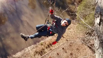

My friend Jon was wounded while in the Army serving in Iraq. He cannot walk or use his left hand because of a brain injury. He does have some use of his legs just not balance. Last week I finally took him climbing and he loved it. Here are some pictures. Picasa

Thanks for the kind words guys, but I enjoyed giving him a chance to leave that wheelchair behind. He is a very determined person and I am sure that contributes to his ability to climb.
Well Gordon, it was a simple ddrt system that was able to be lowered if he couldn't make it down on his own. I used a pinto pulley as an anchor point that was attached to a rope running through two major crotches and back down to a ground anchor. Jon was using a New tribe harness plus there was a webbing strap that went around his back with a revover biner attached to the working side of the rope. this kept his chest upright, however I am in the process of fabricating some padded suspenders that will be more comfortable. He had a Pantin on his left foot, a foot strap on his right that was attached to a right hand ascender. I positioned the climbing hitch (which happens to be the hitch Casey introduced) as low as I could on the saddle.
I tested the system out before he used it and found that the pinto reduces an amazing amount of friction.

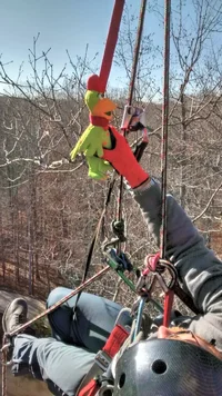

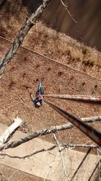

Just wanted to give an update. I haven't been able to climb with Jon for a few years because he had some major surgery and almost died at least three times. God bless anyone who has donated blood, because he wouldn't have made it without you. Anyway this past Friday he saddled up and climbed 60' up a White Oak twice. His objective was to reach the chicken.
