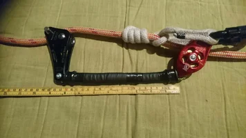

Guys, a recommendation please? I'm sewing up a tether like Levi.co talked about. How long should I make it, center-center? Do I make a rubber bumper on both ends?
This is a michoacan 4/1 on 26" 8mm HRC with a rubber thing on it, for Velocity. Best knot I made so far for DRT. Tried 9 and 10mm Epi, they just feel stickier to tend whenever I find a hitch that grabs.
Assuming you’re happy with your current hitch config for SRT, you want your tether long enough so that when your system is loaded you want enough room above the hitch so the top of the hitch isn’t hitting the rope wrench and you have enough room to get your hand in there on the hitch.
Rubber bumper on wrench end only, on the side where it will prevent the wrench from angling down too low when your system is slack (unloaded).

Thanks moss, I'm not sure about the hitch yet (pic is 24" HRC), so I gave it 8" to begin with.
But why do you say only rubber on the top? I put one on the bottom because it too prevents the wrench and tether from falling down a bit, I would think. It is easy to cut off so if you have any reservations, let me know.
That looks excellent, the bumper on the bottom shouldn’t hurt anything. The tether looks long enough to support a variety of hitch configurations.
