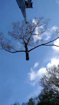

I'm just waiting to finish a large job and get paid. Then, I am going to pull the trigger. Hopefully will be the end of this week. I will keep you posted...But until then..
