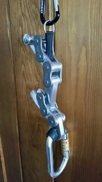

... Maybe DSMc will chime in (he's on V'tex)...and maybe even post more jewelry photos.
Hahaha!!! Has anyone else besides treegongfu and I tried this tether location? I think it is superb! As the BDB advances smoothly up the rope the upper arms are pre-set to instantly engage, no set back.
ML, I also think Vortex is the best rope out there for tree work. The BDB works fine with the small bollard if your rope is new and slick, or no bollard if are using an older piece that is less slick.
Thanks DSMc, I have both new and used. Well as used as a rec climber can make them. Certainly no where near the wear you guys put on them in a year.
Pretty sure mike powers tried that tending location though shorter than in pic above pages ago . I've used that spot as well with just a piece of dynemma bungee. I actually prefer it up the back of the spine ,but being as bungee stretches it ends up in same location whilst tending just on outside of arms not inside .
