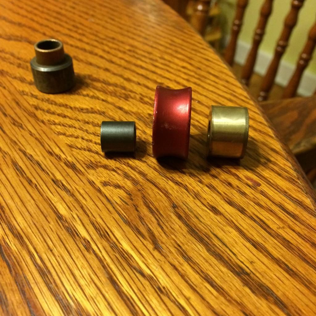

Compact Bulldog Bone
Size comparison to the 1" dmm spacer. The one on the far left is just something I'm messing with. I wonder what the groove in th dmm spacer will do when operating the bone. Just have to find the right size spacer to fit in the dmm spacer before I can test it. Any thoughts?
Being a larger inner diameter, I suspect the rope friction may overcome the axle friction and it may spin during descent. You may also find that it's large for ascent and may not tend well. I don't know. Keep us posted. Maybe you can find some PVC or some other type of tubing that fits just right...
There's bound to be a bronze bushing that will fit the ID of the DMM spacer that has the ID necessary to fit the Bones pin. Check TSC or Northern Tool.
MSC, McMaster-Carr, Grainger. You can look at drill guides or liners also, headless of course. Stay away from die bushings as they will be sharp and have a tapered and or relieved id. I am assuming this bushing is making rope contact (didn't get a bulldog yet), if so stay away from any of the impregnated bronze bushing. The graphite or oil used will make a mess of your rope and will bleed all over when the friction heats up.
The purpose of this bushing would be to fit in a DMM spacer to effectively reduce it inner diameter so that it fit over a pin in the Bone and act as a bollard for smaller lines (such as 11mm).

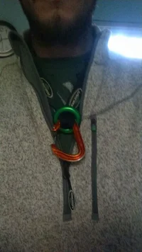

bwktreeserv...just to put it all in one place, here's my adjustable 8 loop harness with a webbing slider on the back cross...
I like the harness. It's a bit like Paul D's, but probably easier to build with things folks already have. Adjustable, too. Nice.
I've got to be honest though, I'm not sold on having a mini biner (or really anything) knocking around on the back of the Bone. I'd just as soon want the connector on my chest harness with a simple loop on the Bone. But that's more in my head than from experience. It may be just fine.
My new arborwear belt/sash with biner right to the hole on the bdb. Seems to be working better than my loop chest harness and I get better stride with my haas too.
I'm using the same setup as gmctr, with two arbor wear belts connected ,with mini quick link on back , soft link bungee for tending on bone , gave just enough to keep it smooth and comfy. Here's a pic of chest harness peeking out. I'm still messing with final connection ,but this one seems ok. I think I'm going to put a swivel boat snap in place of the Ange S and see what happens.14188132301980.webp
