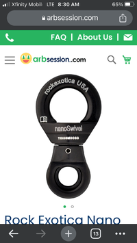

What carabiner is this?
My favorite setup as well. Just in case anyone here has not heard, the DMM swivels are under recall ( see my previous post or google DMM swivel recall) to find details. I just got an email from DMM saying that my units were about ready to repair. I sent my 2 units, one a Director Boss, in for repair about 6 weeks after the recall, so I am near the end or the repair queue. Climb safe.

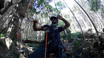

That's was when you headed there to PaulP rigging the TRT floating anchor for a ugly dismantling project??
That was the DSRT/TRT extravaganza. We went up to Seiji’s site and knocked out some good sized Cryptomerias in a sloped forest garden.
Pretty sure the floating TRT was over Japan Rail tracks where a typhoon pushed over a hillside of trees at the top of a big retaining wall. We set up a high floating anchor that allowed us to work the horizontal (bordering on inverted in places) trees by directionally facing them uphill and winching them up to the stable tree line, piece by piece.
Huge props to Paul P for assembling so many amazing events with incredible climbers from around the world!
