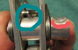

Completed a little maintenance on my new vintage bone this afternoon. I replaced the worn spine with a brand new spine from @surveyor and installed some new stainless steel cotter pins.
Hopefully the new spine helps with using the 11.4mm Samson Predator rope I have. Some preliminary testing indoors has shown some promising results but a few long descents are needed to dial everything in again. If it doesn't, I have a new elongated aluminum bollard to try next!View attachment 84977

It's just bothers me a lot seeing this picture .
Right spine on a picture is well aged spine piece.
Left spine that is installed one is brand new with just few uses of it
You see the difference on wears ?
Left spine that is installed one is brand new with few uses.
Sir I beat the he'll out of these for years , they don't concern me.. they're like a fine wine gotten better with age. Softer lines won't wear them as quick either.

It's nothing wrong with the Device. I'm just hoping can be improved a bit or what not that's all about it. No offences to anyone intended.
