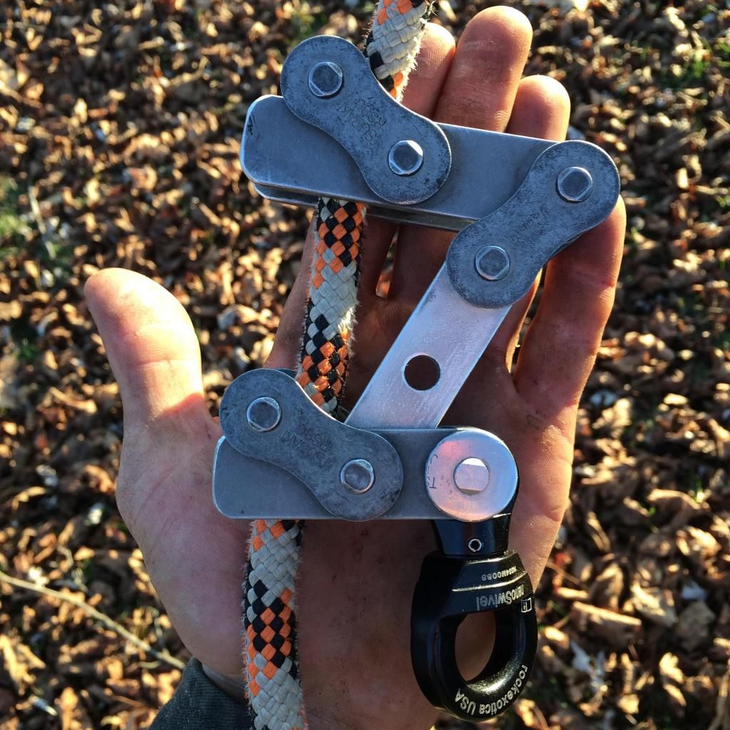

Still enjoying my loan bone, today I took it on and off the rope about ten times in one tree, not because I needed to, but it's so easy, so why not? I did drop a branch on it which activated the top arm. All my weight was in my lanyard so nothing happened, I only noticed due to the amount of slack. Something for me to be aware of.
In regards to a DRT setup, I've seen the video of the prussic cord on the anchor side of the rope, running through the top arm gap, onto the tear drop.. Has anyone done this with a short sling, with a carabiner connecting the sling to a splice/anchor knot? Is this set up still possible on an adjustable bone top arm?
Im waiting for the call from the loaner boner owner () which is inevitable, I'm not sure I can live without one, better hurry up and order my own.. How's stocks looking Gordon?
Better get two Bones while supplies last. : )
The adjustable Bone does not have much space between the bollard and the pivot, as the adjustment screw and baffle use up much of the gap there. However if you are suggesting to anchor the the rope in a DdRT configuration at the bottom teardrop, through the top arm via the strap, then I can report that this will not work. It interferes with the release dynamic of the top arm. It only works to anchor the standing side back to the bridge, and use a prussic merely as a way to hold the Bone in place DdRT to make it self advance.
Here is an excellent video made by Paul, demonstrating the two Bones with two lines.
Nice vid. Looked like slack tending was adversely affected a little, but that's a small price to pay for being able to use two foot ascenders instead of one foot ascender and a knee ascender.
Got a hank of km3 max and it is absolute perfection with the adjustable bone.
I haven't gotten but a quick 30min rec climb on the combo and was hitting swings and drops better on my first or second attempt than with my runner/yale 11.7 setup I've climbed on for over a year. I will say my yale luna is fuzzed up nicely and the bone ran better on some practically new blue moon.
Tends slack so nicely too, easy to clip in to the neck tether and free climb the tree while the bone belays you.
I liked the bone on 11.7 but it wasn't as great as the runner for quick descents and was a bit touchy. Almost like all the way open wasn't enough. Tried some regular kmiii a friend has and it was excellent. This convinced me to get some km max, very glad I did!
Thanks to Gordon, what an incredible device!
Spent my first day on my new bdb, hashtag in love
Yeah, me too. Love it immediately! First day with it yesterday, about two dozen ups and downs in a big spreading cedar I have next to the house. Incredible gadget! Worked almost perfectly right out of the box without even adjusting the bollard on the upper lever. And worked on both my ropes. Tiny bit of extra drag when ascending on the fat Yale stuff I have, but nothing serious. I tried it both SRT and with double rope thru a pulley at the TIP with the bone self tending via a prusik on the standing part. Thanks Gordon!
