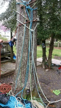

The scandere has an excellent feel in hand, seems a little more springy ,hardly noticeable, love how smooth they both are so as to pull over rough barked up anchor points, I use all natural red is 90 percent of the time so after going through a few that smooth cover is great. If I had to pick one I probably couldn't, both great . I use them in tandem quite often. I love the voyager as well. Using the voyager as my pine takedown line mostly now as I've whooped it up . It's a working man's line for sure, the diameter makes it slightly more difficult to squeeze through gate of quick link which is minor bother . I like the high strength of that ROPE makes for a good static feel. Scion blue reminds of tachyon personally. I use this ROPE the least probably because it got lost in the mix because more shit was coming out and I'm addicted to buying new climb lines to try. I have 200 feet that's hardly used , but it runs amazin in the BONE! 20171223_132359.webp
