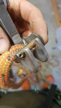

Hi all, I was looking to buy a CBDB and managed to borrow one to try. It's an old model and been through a couple of hands!
Ive only tried it in the garage so far. I tried it on 2 different 11mm ropes, both were very smooth but started to creep after a couple of decents so obviously the bollard isn't right for these ropes. I tried it on my cougar orange, not quite smooth but pretty good, no creep and decends fair well. Although; I could hear it running through the device it sounded.. painful. The rope flattened out heaps more than with my wrench (I haven't used other SRT mechanicals). Also I noticed a bunch of fluff off of my rope on the BDB. Is this all normal? I believe the bollard is the medium size, although I didn't receive any others to try. Looking forward to a real climb

Freddie,
It's normal to see a little "fluff" (tiny 1-2mm bits of rope fiber) on the BDB after descent, especially long descents. This is something that typically happens to 24 strand ropes after they've been run through either a rope wrench, BDB, or any device that puts a bend or kink in the rope. I have not seen this happen with kernmaster, HTP, or similar cordage, however. Don't be alarmed by the fluff. It's normal with ropes that have some mileage on them - newer ropes that haven't started getting that "aged" look (kinda fuzzy looking, I guess you'd call it) yet.

Thanks. I was a bit alarmed by the fluff. This was after a few short descents hanging from my garage ceiling, so no exactly 'long' . This section of rope was quite beaten up from DRT so probably doesn't help. I'll try the tail end and also my blue tounge for a comparison. I was surprised to be able to hear it running through so clearly, hard to explain but almost sounds like a tearing sound. I'll check there's no sharp edges. Other than the above my initial impression was great. A solid feeling device and the operation was intuitive.
Edit: also, should the bollard spin freely on descent? I noticed it was sporadic in rotation but again I haven't tested thoroughly.

I haven't paid attention to the bollard during descent so I cannot provide a yes or no regarding the spinning.
I would venture to say it is supposed to spin
@surveyor could answer this probs
Sent from my SM-G950U1 using Tapatalk
I would say that a frequently used standard Bone would have a bollard that turned. Freddies Bone may be a bit rusty inside the bollard.
