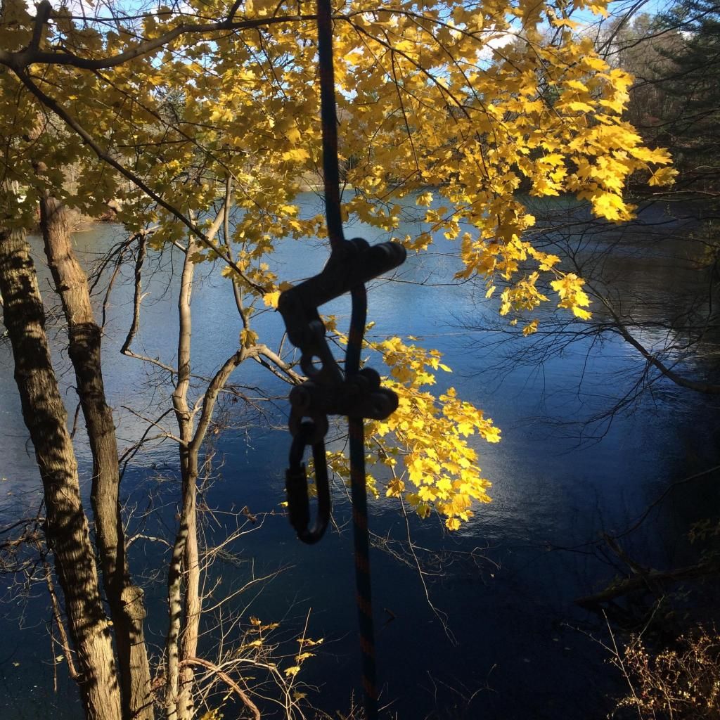

Tom, if you can buy and tap 1/2-20 instead of 1/2-13 you will pick up an extra thread in the arm. Assuming that the arm is 3/16 thick. Not sure it matters in this usage but just throwing it out there.
Had a good view at work today! The new modification added more comfort when operating the bone. I like it :)
ML
Yup...ever little bit helps. On my way home from work I thought of another option. I have some Heli-Coils. This might allow me to use a screw with a special head to become the tab.

I have been biting my tongue to see if more details came out and such, but...I really feel like this whole cross loading thing seems like a user error issue.
I will happily admit I am wrong if I get details indicating I am.
I understand and respect Gordon's quick action with trying to correct any sort of defect.
I have been climbing on this thing for quite a while now, and as many can attest I am not one to baby gear, I have never come close to loading it with enough force crosswise to bend the damn thing. I am only speaking from my experience. I jus thought someone had to say it out loud.
I've taken great notice to the possibility of the occurance happening while on rope in use under load and going up down etc .I don't see it happening .I don't believe physics will allow it ..maybe I'm wrong as I often am.. just been watching intently as I use it and to cross those arms would take some doing .
I hear you mac. I sorta feel the same way at moments but then end up questioning myself. If you take those arms and try with just hand power you could probably cross load them. We've all been dummies and have done things in the tree we thought would never happen. I think the point is to dummy proof this thing. FWIW
No doubt better safe than sorry!
You right, I know you right
I like Chewy's thought, and I found some decent bolts. They're available at my local hardware store...metric, with threads running right up to the head, so you only need 1/64" of chamfer on the hole, if at all. Tight thread pattern, so plenty of bite in the thin arm material. Combo pan/hex head, and the "pan" diameter is spot on for the arm dimension. I'll throw up photos once I get the chance (preferably after the mod). It should look "factory", although I already admit the Chewy bolts would look better.:)
I found some plastic washers that came as spacers on new chainsaws between the powerhead and side cover in place of the bar. In order to mount them I tapped the BDB to 3/8-NC. After mounting I had to file off part of the plastic washer so that the aluminum bars mated. photo 1.webp photo 2.webp photo 3.webp
