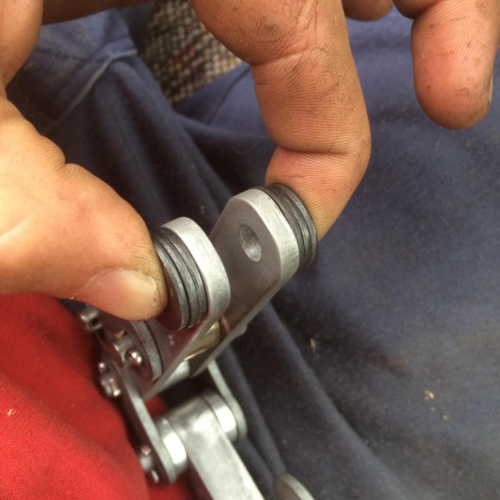

I like all the ideas that came out of this, and how quickly they came to fruition. With that comes another thought...to thin out the height of the arms towards the ends. Thin the bottom of the top arms, and thin the top of the bottom arms so they don't even touch. The lower arms could also be shorter in overall length as well I believe. I've found the Bone works really well in haul back setups without any additional pulley or sheave pinned into the nose. With those being shorter in length, that might also eliminate any contact. It's not with me now so I can't look, but I'll check it out tomorrow.
How does this look??
It may work well and I like the minimalistic nature of that potential fix. I think the problem would be that the top arm may then cross-load on the link itself. It is also nice in my estimation to have the projection of the bottom arm to squeeze against for release, not to mention the possibility for smoother slack tending as it was designed
...It is also nice in my estimation to have the projection of the bottom arm to squeeze against for release...
It was seeing this feature used in Tyler's video (post 222) that closed the sale for me. A squeeze of the hand looks to provide easier control than having to pull down with your whole arm.
Short version...please don't shorten the arms on mine.;)
