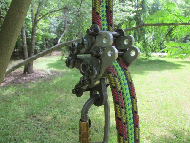

I think the 5/8 bollard comes stock, it is as it showed up. I have the half inch kmiii though. That bone runs from tachyon to kmiii. And as for hitches, I was using the wrench today on kmii with 9 mil epicord. And it ran beautifully. Coulda used one less wrap on my hitch, but that's user error.
How does it perform, Gordon?
I've always thought two bones that connect together would be ideal for dSRT-like what johnnypro suggested for the rope runner in a recent post.
Mac, I am not sure how much it weighs, because my wife left the ounce scale on the stove top while cooking, and if i complain I won't get fed!
Gavin, it tends well and releases like a dream with the 1/2" bollards installed. This franken Bone is a full 1-1/2" wide, which works well
with the double strand links. My though of course is to run three ropes through a floating overhead anchor ala Johnny Pro for 3D positioning.
Probably not practical, and yes it would be better to have each rope with its own release.
It looks good but I think the versatility of being able to separate a double bone into two single bones would be the ultimate for functionality.
Anyway, I use the bdb exclusively for work daily and can't imagine going back to the wrench. It has improved my productivity immensely.
