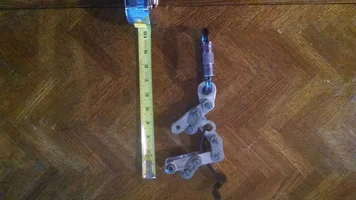

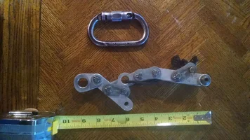

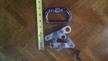

hallo from Czech repulic. I have small question about Bulldog bone. Sory for my english I´m Just beginner.
My question is about draw of bone. It is possible to obtain a picture of the size of Bone?
Just picture with a ruler or if anyone had directly drawing :)

Hope this helps.. Its a beautiful climbing tool.

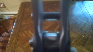

I have a slight wear on my spine that is causing some serious drift on occasion if I don't set the top arm up. Just happening recently . Not such a good pic . hard to get the light right .This is a bone from page 7 of tgis thread with 6061 allie not the new 7075.. i dont remember when that was i got it october last year?? I mix this up with ropewrench depening on tree and moodIMG_20150521_172959008.webp

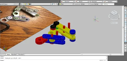

Thank you very much for the picture. Sometimes I make something at home. So attracts me the idea of making a bulldog bone. On the picture is a first step. :) And next my additional aids to climb trees. Home made :) body is Stainless steel strength 8.8 and now 10.4 bolts industrial bearings and pulley made of ABS plastic.
Everything just for my use, it is not intended for sale.

Yes and about wear of Bulldog bone. Alu 6065 has strenght 220kg/mm2 alu 7075 - 520kg/mm2 and stainless steel 540-720kg/mm2
Therefore all use stainless steel. While it is heavier, but stronger

The stock roller of the Bones I make, (both 1/2" and 5/8" dia.) is the roller from the same high carbon steel roller that comes on a standard Roller chain connecting links. I have a bronze bearing insert that fits over the connecting chain link pin and inside the 5/8" steel roller, but the rope bears on this high quality steel. I am interested to see if your SS spine works, because the coefficient of friction is substantially less with SS than with aluminum. The 7075 alloy aluminum is hard to beat, as it is very nearly as strong as steel, but only about half the weight (each Bone has only about 5 oz. of aluminum parts), plus it makes a good heat sink.
