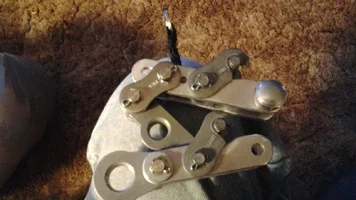

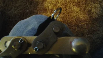

It took about 10 minutes to sew up. It is made with 1/2" nylon web folded over the same size D ring. It is held on by an 1/8" steel shaft. It doesn't need to be very strong as all it needs to do is tend slack.
So what keeps the 1/8" steel shaft in place? I like the looks of this and of course always looking for something I can sew....

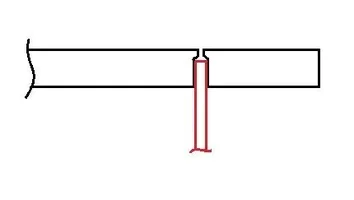

I just drilled straight through and then capped the outside edge of the holes with epoxy. I also glued the pin to the nylon web so it could not slip out even without the epoxy. If I were to do it over I would just drill counter sunk holes from the inside. Not all the way through so the pin would be held in place like a watch bands pin.

You know, I was wondering if a roll pin would help maintain stability between the two upper arms. Perhaps just a tight press fit on the left side (just snug on the right) so it can still come apart easily for Bollard swap?
I could also see drilling a hole through both arms and tapping only one side with the same result above.
Lots of ways to get this done. If Yoyoman was thinking of making a saleable accessory, just bonding the steel pin to the webbing would work and keep it simple for straight through drilling.

Dave, yours is the tending mod I have liked the most, but have you encountered issues with it not being a bungee?
You can buy elastic strap at a Fabric store that's also easy to sew and would combine both ideas. It doesn't have a lot of stretch, compared to bungee cord, but it might be enough. Durability might be an issue, I know that UV makes it crunchy after awhile and it loses its stretch.. but, it's cheap so you could make up a bunch of spares. Of course, it would have to be fairly quick and easy to change them out. That is to say, probably wouldn't lend itself well to a permanent installation. Just a thought.

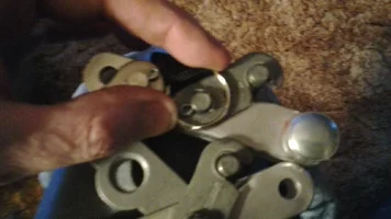

Rich, my pin from Gordon came with a small oversized head that I just tapped in with a hammer and pin punch. No fuss, no muss but I may have had the odd pin.
Clipping directly into the D-ring seems prudent (for those who do not have a D-ring, they can be obtained at Ace hardware and are a 7/8" D-ring). For what it is worth, the hole for the D-ring on all of these third batch Bones are purposely drilled so that a stock size 50 chain link pin can be pressed out of that size chainlink and then press fit perfectly on one side of the top arm at the current D-ring, if a strap is desired . It would be best in my mind to move away entirely from a loop style tether, use your own discretion.
if I was convinced I wanted a bungee attachment I would make a hybrid swing dude/yoyoman (SAKA) chest harness with the bungee incorporated into the shoulder straps.
I'm reluctant to go with the bungee because I like the way the tether holds me in a near vertical position and I think you would lose that with the bungee.
