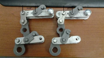

Tico, a fat rope may indeed work with no bollard at all. You would just have to try it and see if it grips and holds reliably.
ive played around with 13mm lines and it works but it is not as smooth. paying out rope without weigh, like when limbwalking, just isnt as smooth. this is my experience without any bollard. my version of the bone does not have the extra holes to adjust as much.
was shoveling my roof last week (while tied it using the bone because im a sissy when it comes to roof walkin, even tho i live in a single floor ranch) a section of my rope got frozen and simply was not going to pass thru the bone. it was not flexible enough to pass thru the bending points.

Tico when you get yours all this talk will make more sense. There are lots of ways to adust the friction on the bone. Some come straight from Gordon when you order it and some are just home grown modifications that we try and pass on. Not every combination or modification works for everyones personal variables. My bones are kind of unique with the 1" spacing. I think only a few of us have them that small. I have tried them without a bollard but for me I liked the feel better with the 5/8 bollard. I think some guys have this combo but prefer no bollard, it really just comes down to personal choice with your particular variables. One of the fun things about the Bone and the RR for me was getting in at ground level. It gave me the chance to financially help the inventor by buying one directly, work on personal modifications easier (no rivets), pass my results on through this forum and hopefully help all involved with getting the best products and advice out there. There are always a few hiccups with all new products, and sometimes when reading through some of the threads on here you will read some negative comments about a product but 99% of those are only said to bring light to a small problem. If you read enough on here (Treebuzz) you will see that most products that people don't like and get resold are not really bad products, in fact they are loved by others, they just did not fit into the current owners personal preferences. Get a BDB and have fun, tweak it if needed and let us all know any mods you make and if they worked. More importantly don't think about as buying a piece of gear, but think of it as buying a piece of the future. That statement goes to all new ideas on here as far as I'm concerned whether it's the; BDB, RR, THT, X-Rings, Uni, Richards Uni drum or Magnets........They are all good products for someone. I equate all the different products to Ford vs Chevy vs Dodge. And I almost forgot....Wecome to The Buzz Tico.
Right now I am using 1/2" rope. The new bone tends a bit better than the first model with 5/8" bollard. Small bollard slips to much with my weight. I am ordering 120' of tachyon this week. Should be no er than what I have now.

You are going to love it on that Tachyon!!! I already can tell... so you don't need to have your doubts. 5/8" bollard on the new Bone with Tachyon is sweet!!!
