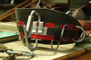

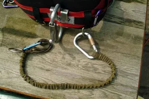

I use a stretch sling with a biner to my harnas and an eye looped in to the saw with a small biner. The ring is to hook my saw into the big fixed hook on my belt. (its from an old Komet harnas i used) That hook is big enough to hold de gashandle from a MS660 or 088. Its a handy hook, i can take/hang my MS200 single handed without problems. I have minor problems with strugling branches getting hooked up. It happens, but not so often.
My brother got one of those saw hooks from Fresco and is really happy with it.
Keep in mind that there are two types of that hook. A fixed one with those braces around a harnas belt and a simple type that hangs loose. For the one i have its recommended to have a firm plate stitched in youre belt to support it. If not the load of the saw(s) can give a nasty twist and hang to youre back. Ill make some more pics of those hooks. As for that extra support, i have the Cresto belt with firm wide backplate and sitting plate. The Komet belt had some extra plastic plate stitched inside the back where the hook was placed.

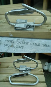

Another thing it showed to me - and I arrive at the point I was trying to make in a round about way - is a lot of these things are about configuration. Take the hook in question:
In France, where the Komet hook comes from, it's had some really bad press: The spring tends to break and on harnesses where the webbing is not attached on really well - like, for instance on Edelrid's TreeMagic (check out Frans Smith's comments on this issue) - it may well rip out the webbing. The result in both cases may well be dropped chainsaws. Also: You're attaching gear to load bearing elements of PPE. Same with weak gear loops on a number of harnesses. What do you do? Pop a carabiner under the webbing and you've got yourself an attachment point that's bomb proof.

I get the picture i quess. I can say that i have experienced a 020T drop while connected to my harnas. It did give a pull but simply that steel eye on the saw broke of. I did use a weak clip between the sling and harnas in the past, but that broke much to easily. I lost my saw several times because it broke at not that much stress/load. I use an old worn biner that i dont screw in. So i (hope) if it goes wrong it bend open or again rip the eye of the saw. Not a bad idea to bring these things up, i see what ill can change. That komet hook i have in use for 8 years i believe. Have no problems with it like braking springs or torn webbings. When using bigger saws i just clip them right in on the back handle. When making a difficult cut i use a piece of rope to tie the saw direct to the tree and not to my harnas. Maybe some more effort but if i have to let go the saw it stays in the tree insted of getting smacked at the ground.
No, you're right about the Komet hooks, I believe it's the newer models that are a problem. I'll see if I can find a picture.
This one ? (edit: small komet hook)
or what about this?
or this (a cresto hook that should be on my harnas)

The dodgy Komet hook is the bottom one. I ought to say that I'm relying heavily on info from french climbers here, I don't have first hand experience of the hook, but they're hopping mad about the whole business, as people have been hurt by falling saws and Komet doesen't see fit to respond to complaints.
