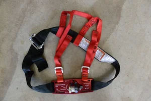

My favorite for long ascents is a PMI chest roller and an On Rope 1 H-harness (see pic). If you cinch the harness down tight it holds you so upright that you can ascend hands free, and for some devices like the Rope Runner and Hitch Hiker it automatically tends the ascender up the rope as you walk up. . For ladies (and guys too really), the trick is to wear the roller high on the chest (above the "boobs") because that is the only comfortable way to wear it, and it keeps you more upright.
If you are on a Rope Runner or Hitch Hiker all you have to do when you get to the top of your ascent is unclip the rope from the roller and from your foot ascenders and go to work. If you are a tall person you may have to use a 3 or 4" runner between your saddle and the ascender so that the ascender will ride above the roller. That takes a bit of getting used to, but I don't find it particularly bad.
And yes, I know it is bad form to etch your initials into any climbing hardware, plus it may void the warranty. So don't do as I do!
