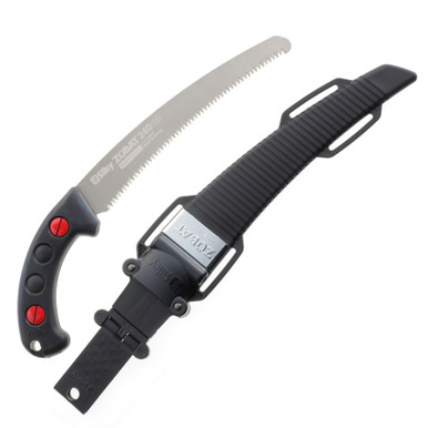

Didn’t you just get into climbing?
No offense, but I recommend this.
Then this:
When you got that down go for this:
Walk then run.
Tony
If I remember right, he has been a certified arborist for 6 years or so and is only new to the climbing part of the job, not the pruning.
Fair enough, if I made a false assumption. I’d still recommend the silky and stay well away from a pole saw until it is used not as a crutch, but as the right tool for the job. Even if as a new climber efficiency is being lost.
