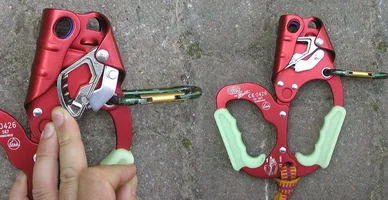

I've just bought the new Kong double ascender (take a look at the attachment). In this one there is a new hole added.
I really don't see a problem if you modify the old ones by drilling a hole about 1/4 inch to the left and up from where the rivet is in the previous model, just to fit a little clip.
Wolter

I've been looking for a carabiner that would fit through the top holes of the newer model to use as part of a back up for footlocking a doubled rope. There are other ways to do this, but I've become curious about finding a 'biner for this purpose. If you can't fit any 'biner in the holes then what are they for?
We do use a key chain 'biner as in Wolter's attachment to limit the opening of the cams.

The hole in the top is still there from the time those ascenders where used without handles.
Ascending/backup in rockclimbing was/can be done by putting the ascender on the rope and than a biner in the top hole AROUND the rope.
Pulling the ascender along the rope it runs free (look at the shape of the hole). Falling into the ascender means tightning the biner onto the rope due to the shape of the top hole.
Wolter
Sorry, don't understand. How couldthey be used without handles? Do you mean before two ascenders were assembled together to form one unit?
Can you show a photo? I can't find any carabiner that will fit through either of the top holes in the unit that you show. I can, however, see how a carabiner would fit through either 'side' if there were originally two separate ascenders.

First, the gear we use, is safe to use for the purpose it is designed for.
The pic shows a config as a backup system while using a preset line. The line is not to be used as a means of access, but as a backupline while doing your walk/climb.
The purpose for the ascender with the handle is to use in a free upward way in a cave or on a rock, not in a tree with twigs and branches.
Recreational rock climbing can be done with quickdraws/biners without safety features on them like screw lock/tripple locking biners. That doesn't mean we should use them in our industry.
If we start to use stuff from other diciplines, we have to evaluate if those things are made for the purpose we want to give them.
In this case (the unmodified handled ascender) the arborists are dropping to the groud like leaves at the end of the season. Those things are not desighned for us arbo's in the twiggy treetops and even less if we climb thru the tree standing on branches (tilting the thing upside down).
Kong has modified it's ascenders for the use in this industry after numerous accidents.
Use that modified one or (I did not state the next line ;-)) modify your old one to the standard as they should be.

I have the newer model of the Kongs and I've used a little 'biner in the bottom hole (as in Wolter's first pic) ever since I got them. This may help prevent the rope from popping completely out of the ascender, but the pressure on the cam can still be released. The pressure has to be released in order to advance the ascenders up the rope, but, if this occurs accidentally and/or without the climber realizing it, the climber can fall.

Plain and simple you need a pin through there. Tom has the better idea with washer to catch the "ball". The small biner to limit opening of the cams is not that great. It still opens enough to catch some of the jacket as opposed to all of it. Therefore tearing the jacket as you continue to drop. Maybe it will jam enough maybe not. Let me know when it happens. The jacket on most ropes I beleive tear in the 1k range, that's with full contact on the jacket. Hopefully it will catch and close on the whole rope.
Also, using the top holes on the ascender as your point for back-up is not ideal either. These ascenders are not for fall protection. They don't even comply with KN requirements. They have obviously held our weight and such but let's remember what the design is intended for and make adjustments. Ascenders are not fall protection. Config. your back-up accordingly. Alot of guys/gals use the frame as some point of catch if failure were to happen. Think about it....
