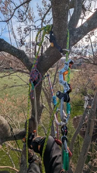

Apologies for the clutter, but this setup worked perfectly for me the other day.
I set the yellow StatX (200') from the ground and used a homemade soft 8 for an anchor. I had about 100' for retrieval and 100' to climb on.
I then climbed up to my tie in with the purple Kalimba (~90') and set that as another soft 8 (fimblsaver). On this system, I only gave myself about 5' of rope for the retrieval end, which attached to the knot block on the StatX.
I ended up taking 1 redirect with StatX and 2 with Kalimba. Both ropes were retrieved by pulling on just the one retrieval end of StatX, and everything came out beautifully.
Again, @SoftBankHawks did all the heavy lifting for me on this one. Can't thank him enough. This is how I climb most of the time now.
What’s the point of climbing with two lines like that?
