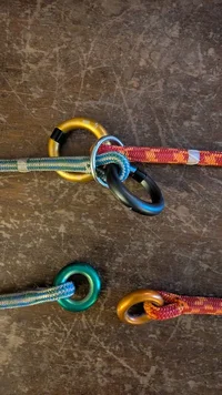

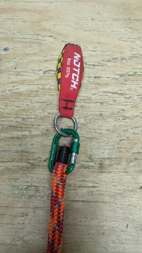

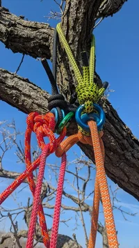

Anybody seen the "American Clacker" yet? Buddy showed his to me and I loved it so much I made my own. I think he had Arbsession make him one. Its essentially two ring'n'ring friction savers that are bound by a floating ring. The savers are oriented opposite each other and each large ring of the savers will jam on the capture ring during retrieval. I use a DMM locking micro xsre spiked in the end of the line a retrieval ball. The xsre also allows for easy attachment of a throw weight so you can chuck the end of your line trough the canopy of the tree and then not have to go to the desired redirect union. This things uses two ropes so you need two independent climbing systems. It must be installed manually but retrieval is remote, utilizing each of the climbing lines. pic 4 is one I made with knots before I committed to splicing up a clean one. the red rope that is through both knot blocked alpines is just for retrieval. you can go through a ton of redirects and it'll pull out easily. You also don't need really long ropes.
