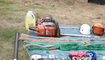

Here's a pic of the 1.25 gallon container we purchase it in.
We buy it by the case of (4).
Never had an issue with it flowing in the cold.
