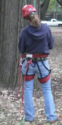

For people that have them could you show me some close up pics i would like some to get a better view of the saddle.
another photo
not sure if these will help
cool thanks anyone else have some pictures? i would like to get a close up of leg straps d ring area and back of saddle
Here's a few...
Any coordination in colors is purely coincidental, but it ain't bad now that I look at it that way.
I kinda like paddle biners. I use that one and another one to haul up my chainsaw pretty much every day. What bugs you about'em?
