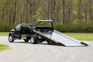

There's a guy around here that uses a medium duty rollback truck to haul equipment around. That could also tow a dump trailer, and would allow one guy to show up with a machine to load material into the trailer, and drive off with the machine and the loaded logs...
Im moving towards this setup myself. I’ve settled on a 4x4 flatbed, maybe a service body.. I could easily rig it for my dump insert when desired, tow a chipper and have the mini on the bed (possibly in the dump insert).
Basically a boss rig, where I could leave the guys and go do my own thing for the middle half of the day.
I like that too. Certainly better than moving the ramps around. We'll have to explore cost options. Obviously, 10 ft long heavy duty aluminum ramps are not going to be cheap...
The disadvantage I see what they roll off truck like that:
*Surface would be slick when wet and with mud on the tires I doubt the machine could make the climb.
*I think many hydrostatic loaders (I'm sure I read this is the case for the Avant) cannot be put into "neutral" allowing them to be food up with the cable.
---I suppose it would just take some coordination with a remote on the tow cable and driving the unit to get it up there if it is slick.
I'm thinking through options again... I still think I want a flatbed truck to haul the loader (Avant). Has anyone ever had a dovetail truck with a trailer hitch on it? Obviously would have to unhook trailer each time. Or just a flatbed with ramps?
An equipment trailer or dump trailer? If it's an equipment trailer you can ramp from the trailer to the truck bed, allowing for smaller ramps. This would require that the trailer be unloaded at every job. Depending on what is being towed, it may need unloaded for use at most jobs anyways.
I've side loaded a smaller mini skid with 10' ramps onto a flatbed and into a chip box. I'm not sure I'd want to sideload an articulating loader. That weight is a lot of torque on the frame, suspension and bed.
I'm glad I don't side load anymore now that I have a bobcat 100, it's about 1000lbs heavier than my old machine.
There is a really aggressive coating you can put on a rollback deck that will pretty much eliminate the muddy tire problem. One of the rental companies locally uses it on all of their trucks, you have to be careful running your hand across it because it will skin your fingers in a hurry, but it gives great traction for rubber tire machines. I can find the name of the stuff if you would like.
If you think of it, that would be great... Don't go out of your way. For now I'll just put it on the list of possibilities. If I end up with a vehicle where I need that, I'm a bug you again if you don't come across it easy now. Thanks!
Dump trailer.
Currently haul the loader in that It need to stop back at the job site to pick up the loader after dumping. My goal is to eliminate that return visit.
In Avant 528 only weighs 3100 lb without attachments... The thought of sideloading gives me pause. I was generally asking to see if that concern is well placed, or if it is actually safe to do. It is kind of sounding like it is less than ideal.

My mini was 2200lbs on an old f350. I'd be pretty hesitant to do it with my current mini. A bigger truck it'd probably be fine. With that angle of a ramp, a wheeled machine is steadier on the breakover than a tracked machine.

I called the rental company today that uses is, they tell me they use a product made by Scorpion Bedliners. It is mixed with an "extremely aggressive grit" that to me looks like a finer version of the gravel they spread on a tar and chip road. Really aggressive, to say the least. They say there's a local shop here that applies it for them, I'm sure there's one near you too.
