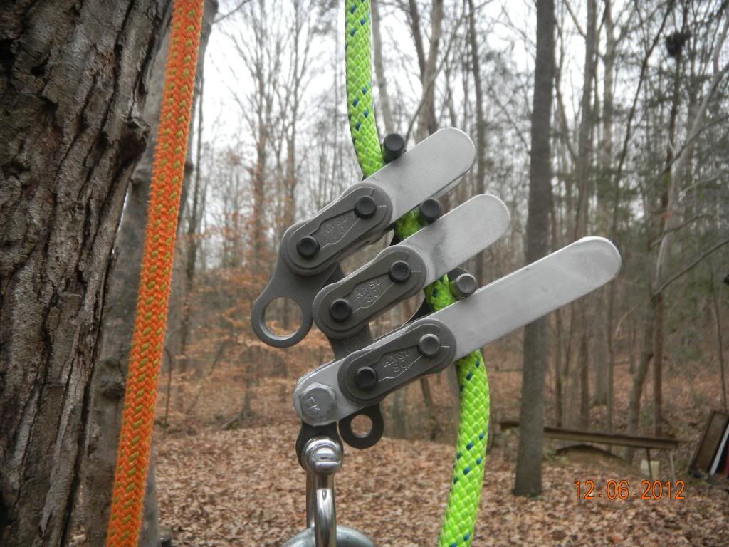

Tony, To have a device release smoothly, on various size and construction of ropes (harder, softer, denser, more supple) and with various weights of the climbers, is a real challenge. With the OAR it is possible to change the roller size and/or add more rack arms. I have found that the 4 arm OAR, with rollers that will accept up to a 1/2" rope size is a good choice for allowing various size rope to work on the same device. The bottom most arm, when pulled down to release, causes the rope to take a bend around the roller above, and however many other chain link pins and rollers which are above. This gives the option of releasing either one or two of the bottom arms to release smoothly with various size/construction/loads.
For DdRT, you actually only need two rack arms for the OAR to function with Tachyon. (see Bings pictures and comments of his two arm OAR on the Arbtalk site, under my "Dogbone" thread). As a result you could choose to only weave the rope on the top two arms DdRT, and leave the bottom two off, or you could weave all four rack arms on the line and then release all three of the bottom arms at once. In this manner you can "tune" the setup of the OAR for various needs.

I have had the master swivel links treated with black oxide, sort of like anodizing on aluminum. This will add corrosion resistance. The aluminum arms were water cut. The OAR on the right is set up for use on KM III, and I have used larger links for the connect points. I bored out the hole so that a biner will attach directly to the OAR top and bottom. These ANSI size 80 links are some tough steel, my cobalt drill bit will hardly touch them.
I look forward to your comments.
Gordon

I have made this multiple anchor OAR. If you anchor at the leftmost anchor point (pictured) it gives the most gripping force and will grip on a KMIII SRT. For larger Dia. rope you can anchor at the rightmost anchor point (inline with the spine) and it grips for use DdRT or SRT. If you want a gripping force somewhere in between then the anchors can be swiveled to meet together halfway.
Re: slack tending OAR
Made a refinement to the attach point. It has an adjustable anchor point that uses the brass thumb nut to adjust more grip if needed. It will adjust from almost inline with the spine to 3/4" more of mechanical advantage to the gripping power inherent with the OAR. This allows for a fine tuning of the grip depending on the type of rope and the climbers weight.
