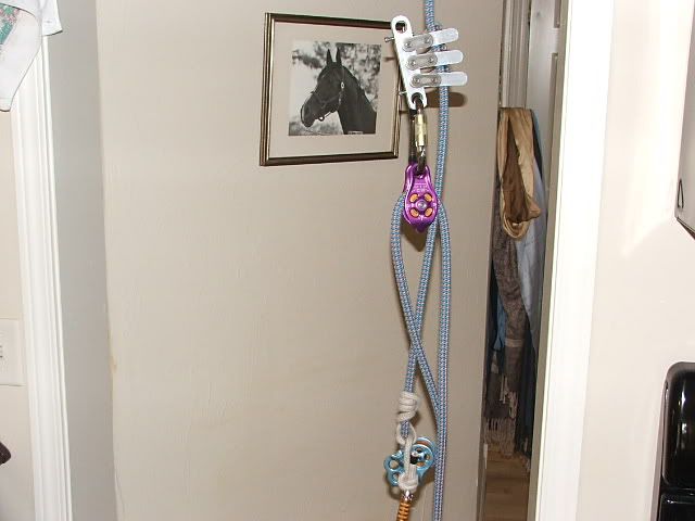

Surveyor, because I am relying on the OAR to support me and take most of the friction I would recommend using a rated double locking carabiner and use the carabiner or pulley as the "redirect."
Here is a pic, from the first pic I posted just unclip and add a pulley
the hitch is there as a kind of spacer to allow the OAR to be used as a RW type of device. The OAR provides almost all of the friction and the hitch provides a little. Advancing the OAR with the hitchclimber is more natural. I found that this is much smoother for me. It might be different for other people. I also like having a hitch for other tricks, like the one listed above. Unlike the UNI the OAR has steel points for wear which I can't see wearing out.
I did a static load test of the Bulldog OAR pictured in this thread and it held well over 400 lbs. (approx 440) before it began to creep slowly down the rope (tachyon). It is very rope friendly because of the smooth round friction points.

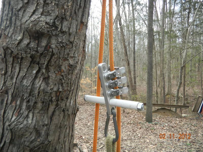

I have added a double sided handle to the Bulldog OAR and can ascend with just a pantin and the OAR (thanks Sawdustsmokin for the pantin). I pull myself to a standing postion with arms and leg and then slide the OAR up rope, then repeat. To descend, I unclip the pantin and am good to go.

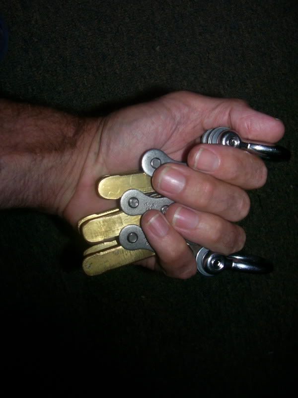

I am still working on the OAR design, and this one shows promise. This OAR will tend slack by pulling the rope sideways or upwards due to the attach points using the roller links, allowing the anchor to swivel, causing the whole OAR to pivot at the bottom arm when tending slack.

Why the aluminum bronze now for the "fingers"? Corrosion resistance? Or a way to get a harder material than the anodizing regular aluminum?

Thanks, The arms are actually made of brass on this 3/4 size OAR, but aluminum bronze would be a good choice also.
Re: slack tending OAR
I guess I like to experiment with different material and have used aluminum, brass, stainless, aluminum bronze, mild and high carbon steel so far.
