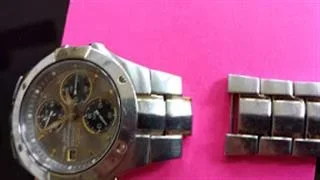

The other day I was riding in a bus and felt my watch fall from my wrist, looked down and picked it up from the floor, it was dark and I thought to myself, darn, now I have to buy another of those pins because I will never find it here in the dark, upon a closer look the pin was still there, JUST LIKE YOU SEE IN THE PICTURE!!
Can someone tell me how in the hell that pin opened enough for the band to let go and then went back into the position you see it. I think you all know what I'm talking about, it seems impossible to me and I don't have any idea how it did that!!!!!!!!!!!!!!!! The pin is in perfect condition, no bends, breaks etc. I re-secured the same pin and have not had a problem for several months. I'M "KNOT" MAKING THIS UP! Believe me, I Tie, Dress and Set my knots and check them too.
I think the watch issue has a relatively easy explanation: Teleportation. Your evil doppleganger, OyOy residing in the 4th dimension, transported the pin to his nether world's molecular storage zone. A second later, just to f*ck with you, he popped it back on your band
