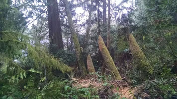

If you want to grab a vertical/ upright trunk, you need to be able to get close, extend the grapple boom partway, rev up, quickly reverse then forward with the machine and up with the boom swinging the grapple forward and grabbing the trunk.
I "walked down" this uprooted fir until I was getting the tree trunk smaller and lighter. This is the last picture before I swung the grapple, grabbed the remaining part, lifted a little, and backed away.IMG_20180327_094920838.webp
