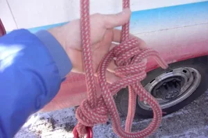

This shows how a Blake's can be inadvertently maid as a suislide, whereby the bitters pulls away from the host, rather than locking into it; by the directional rotation of the standing tension.

How about 4 of each L-R forward / backward as T. describes (total of eight) and same fer Tautline (dozen). And let the experts / proctor sort'em out in a couple of minutes(without touching, seeing only 1 side?). How are the qualifiers qualifieded? The mechanical design of the 'slide lends towards walking the low-Zer0 tension bitter tail out by the most powerful tensioned pull of the standing. Conversely the Blake's uses the same force to properly lock the bitter end.
In small diameters, dressed right, playing around as an easy arm chair quarterback on a Tuesday afterbnoon sippin'tea with soft pulls; you can get some fair tack from the 'slide. But, if a real working man was climbing on it any length of time with dynamic shifts and impacts (let alone everyday).... well still being h'ear kinda proves his case IMLHO!

Went to tie it yesterday and noticed somthing different so I looked a little closer...

I tried both knots today...
Seems like the knot in question (niceviws 1st post) doesn't bite as hard as if tail goes behind wraps.
Correction:
Sorry, I got it backwards. the one I tied is the Suislide, not to be confused with the Blake's which Niceviews tied...

as long as you capture the bridge either way should work
Looks like the suislide pulls the tail end right out of the knot, deforms it pretty bad. Won't bite as hard on the rope, tends to slip more.
Seems like if you didn't have a stopper knot on the suislide things could go bad quick.
