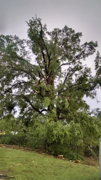

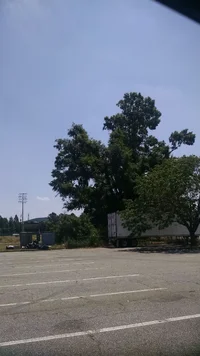

Here is the example I have been working with. Willow oak. Original dimensions were 97' tall, 110' spread, 7' DBH. As far as I know it is the third largest in Georgia. First photo is immediately after tornado/straight-line wind event in April 2017. Second photo is today, 13 months later. Corrective pruning occured in September 2017 after sprouting began. No entire limbs/leads were removed.

Really appreciate your post, pictures are worth a thousand words! Nice little article in the link you provides as well!
That's an impressive tree, worthy of saving for sure. We had a type of oak near where we hunt that 4 guys hand in hand could not get around and it was Beautiful. Paper company poisoned it because it cast to big of a shadow on their precious pines. It hurt my heart! Imagine if these big old majestic trees could tell you the stories of what they have endured!
Good work, shitty site for a heritage tree?

Damnit oldoak you missed that hanger! Lower right and up three limbs, next to the dead stub, but up a little higher and to the left

Agreed. Kind of relates to the difference between "Foresters" and "Arborists". I can understand forresters planting and harvesting as that is how they make their money. I wish though sometimes fine examples such as this and the one i was referring to would be left and appreciated. Great job btw!
Actually the site was previously a par 3 golf course. The city turned it into its Civic center and softball fields for the '96 Olympics. The tree was saved and well protected until the winds of last April.
