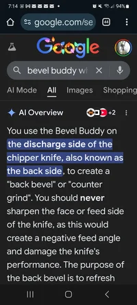

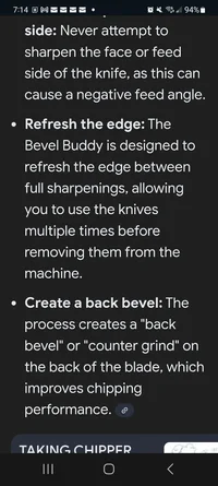

Am I reading this wrong?
Is the "back" or 'front' side the large bevel side?
Do you think the BB grinds the main surface of the blade that is ground off by the pro sharpening?
The BB cautions to only use 3 light touch-ups between pro sharpenings to avoid Too much back bevel.

From your picture, Bevel Buddy sharpens the B side, or the back side of the knife, not the side that is sharpened from the factory or sharpening service.
Merle's tool is just like the Accusharp you posted, except it only has one carbide blade and it sharpens side A/the factory sharpened side while leaving the back side/B side unaltered.
Yes, that's my take.
