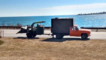

Correct. 87 Chevy 3500 with upgraded suspension, wheels and brakes. Gvw is 14500. 10 yards is more like it for the body. Mostly local jobs within 15 miles or closer. Dumping chips before hauling chipper back is usually an option. I have enough work to justify the 550 but I'm trying to spread out buying everything at once. Great hearing how others have built their business.
12 yards @500 is 6,000lbs but I agree. I got a F350 w/ 13,300 gvw and it is not hard to get overweight at all. My guess is your box probably holds about 9-10 yards.
9-10 yards is spot on. My old truck is in mint condition and owes me nothing but an upgrade will be in the future and keep the old girl for a firewood truck.
