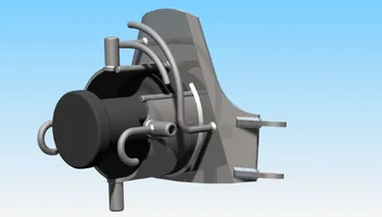

I found the working draw off the winchbolder on my laptop.
In the meantime its allready gone from drawing to a real life thing.
But there's nothing changed compared to the drawing.
see for yourselves :
Looks good. Let's just hope the price is affordable.

And BTW treestyler.. that's an awesome design there.. now there is some creativity
The design is not mine it's from Steven Ibelings.
He has figured it out and made the technical drawings. He has made about 10 off them and they are allready for sale.
The price i'm not sure about but it's something around 2400 euros.
it's worth it's price in gold in my opinion and it's better then the GRCS because there's no need to switch between things. You can easily winch and use the bolder at the same time.
