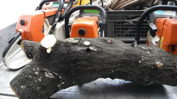

Found what may be ALB on a giant oak we had to remove from recent storm damage on the local private country club and sent picts. to appropriate authorities today.
alb doesn't mess with the oaks, dave. maples, birch, willow, poplar, jap katsura, linden i think, and a bunch of other host trees. luckily it doesn't have a taste for the truly hard woods even though it loves it some sugar maple.
in my opinion the only true way to beat that f'er is wholesale removal of all infected and even host trees in the area. you can always replant.
You are both correct Justin and Banjo. Both Joe Boggs and Dan Herms ID'd it likely to be Clearwing borer. I was not aware 'til now oak was not a host.
Thanks for info.
