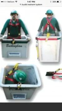

Here is Buckinghams solution to being secured in the bucket from ejecting.
However they are showing a belt only which won't be allowed after Jan. 17.
Again, unless I'm missing something, that setup would be useless to me. I am constantly turning, spinning, reaching and leaning when I use a bucket. Looks seriously restrictive. Linemen generally face one direction I'm guessing. Trees are three dimensional.
