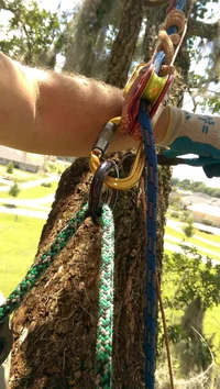

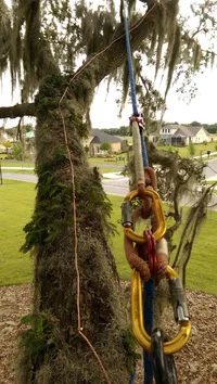

My main issues at this point are:
1. My hitch is hard to reach while limb walking. Seems like two oval dmm biners and a standard dmm pulley look longish and I keep thinking about a shorter tether and some kind of shackle system. Then I just want to forget it and get an rr or akimbo. I see many different configs on the rw, and lots of cheering from the galleries, but the reason for them is not always apparent to me. Is compaction of the system the primary goal? It sure is mine.
2. I don't know when my hitch cord is "worn out". I'm on my 4th oceans 10mm in two years, but feel like I'm sort of guessing. I'm not at production level frequency yet - just climbing an average of 2 days per week.
3. Keeping my atlas smurf gloves out of my hitch, which may not be a problem if I start gripping the whole hitch instead of just the top wrap, on decent.
Pictures of my rw setup are attached.
Any thoughts are appreciated.
i would suggest you shorten your bridge. Mine is pretty short and this keeps whatever system close to you. the one time a long bridge is nice is dDrt. But yeah shorten your bridge and get it to where you can reach your hitch easy. People say that the RW system isn't compact, but in my feeling, the wrench really doesn't add length to the working system, the system is as compact as the hitch, the wrench just does its thin and I don't worry about it. when i need to get close to the spar, i can get as close as my hitch allows me, the semi rigid tether allows the wrench to come right to the top of my hitch only adding an inch or too to my working system. It looks like you could get your rope bridge shorter by quite a bit
One thing that might make a considerable improvement is a slightly shorter hitch with sewn eyes. The overal hitch often ends up being more responsive, with less sit back.
I would recommend you order a 28" 10mm EpiCORD with sewn eyes and give it a whirl in a Michoacan config on that cougar.
