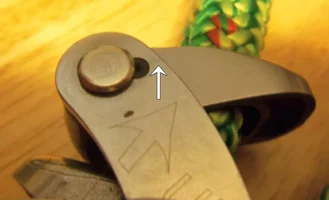

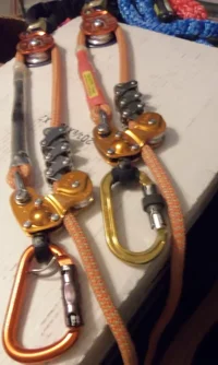

Jeff, is there a way to tell by serial number or packaging which version of zig-zag one has, as in ver. 2 vs. 3?
Yes. But the easiest way is to just look at them. The link plates have been beefed up, and it is really obvious. Especially the top ones.
Pics are V3 on left, V2 on right in all of them. The area shown by arrows makes it easy to identify them. I don't remember the serial number cutoff point for the switch to V3.
Pics are a bit fuzzy, sorry about that...
